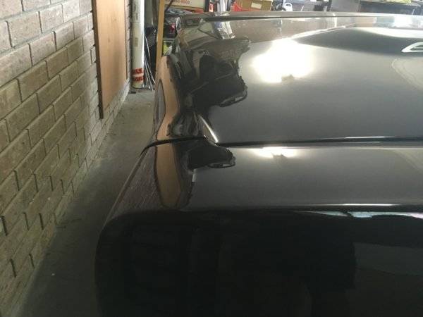

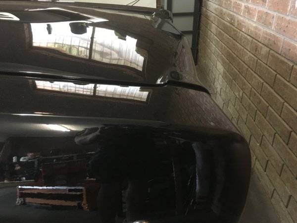

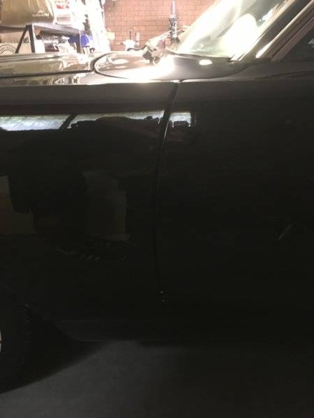

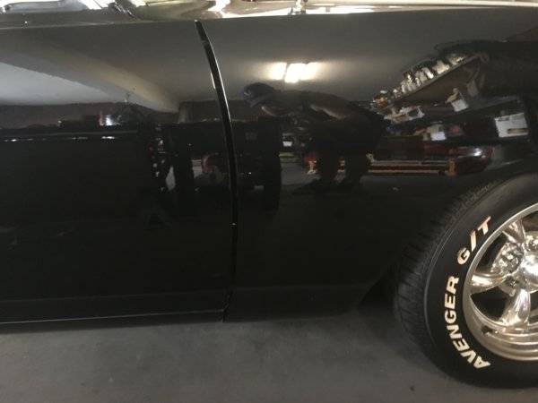

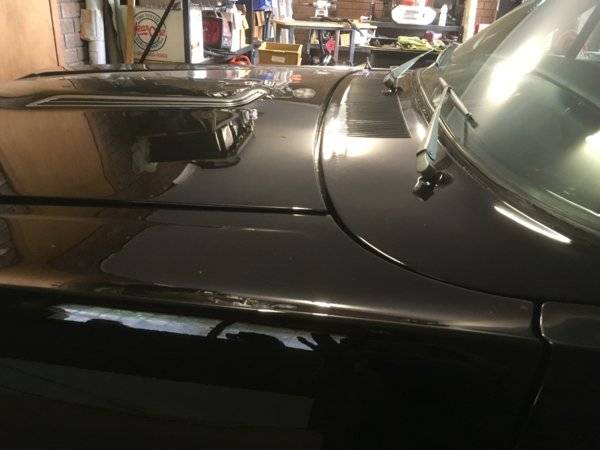

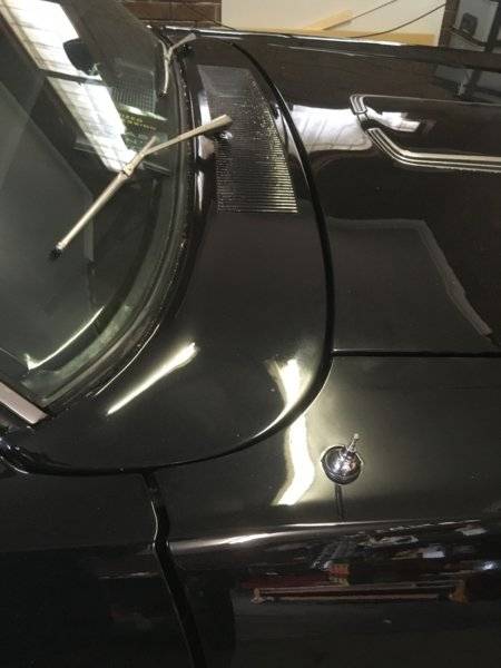

So I may have over estimated the gap. Maybe closer to 1/3” anyway here are some pics:
Sorry I’m an Aussie - bonnet=hood, front quarter=guard, fender etc.
fenders look ok...... looks to me like your hood latch is too high, not allowing the hood to sit on the stops

Tried everything, same result. Anyway looked around a bit more and realised the radiator cap had been fouling on the inside of the hood. Removed the cap and bam **** lines up nicely.
Looks like I’ll need to adjust the radiator down. Must be a smidge too high.
