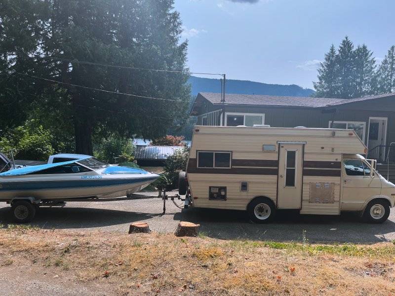

Couple of good looking tree stumps in the foreground......

The 318 is a great small block engine.
Now ask it to tote that camper and what you pack in it. It will do the job.
Now stick a boat and trailer behind it.
That 318 will still rise to the challenge.
Now stick a mountain in front of it on a summer day.
Yep that 318 will still do the job but that sucker is going to start complaining.
2bbl, 4bbl it's not really going to matter outside of the fact you will get really good a tuning a holley if you swap.
Toss a electric fan and manual switch on it for the big hills . I would leave the 2bbl on and just take good care of the engine , tune ups ect.
