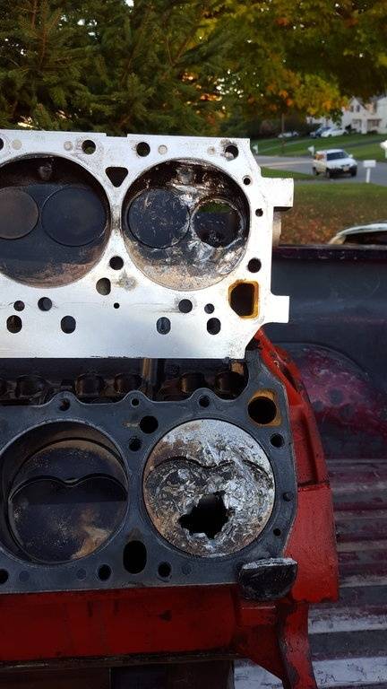

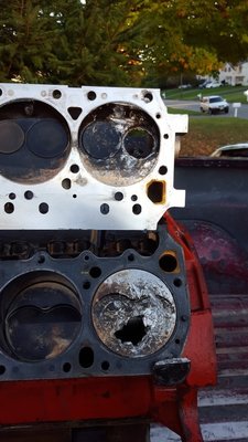

I ran the stealth heads. Replaced all as stated above and still found a weak link.
One of the valves just snapped off.
I rebuilt the heads and now they have new manley valves as well.
