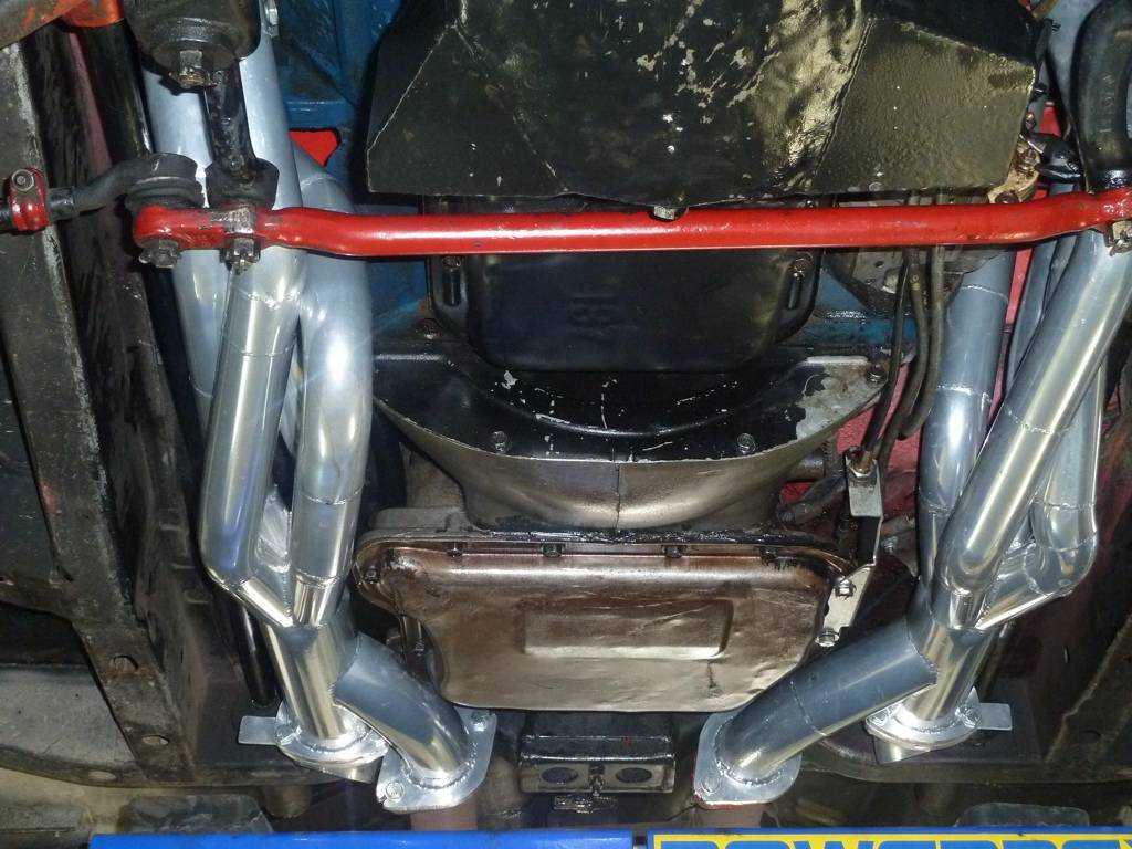

Hedman 78030's
Great fit and great pricing.
Driver side goes in from the top and passenger side up from the bottom.
No clearance issues and I even used studs in the heads!
