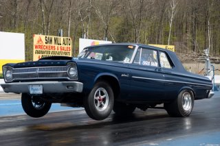

Hemis are front heavy, 6 cylinder t bars might be too weak. I have /6 bars in mine with a great set of double adjustable shocks. If your front shocks are marginal nothing is going to help you unless you have gobs of torque.
And the proper torque converter is a must to get you in the sweet spot on launch.

The rear suspension is important too. What do you have back there? My last car which ran 10.60's had /6 bars but my rear was a ladder bar set up and it would yank the front up up too quick only to land too quick and unload the rear tires. After chasing my tail for a good bit, a good set of front shocks did the trick to help tame it down some. Instead of picking up the fronts a good foot and then landing too quick, it would pick up the fronts about 3" but would carry them out further before landing easily. That ended the traction issues. Is your Hemi all cast iron? If you have aluminum heads etc, then the weight might not be a factor so much but knowing front to rear weight bias would help make a decision on springs and if you plan on taking weight off the front, then you might wait until you are done with that so you can weigh the results then pick springs.

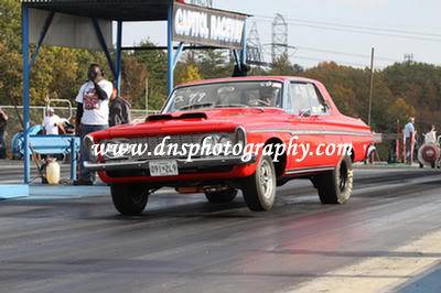

I use the stock 383 bars in my 63 Sport Fury with a 440/493. It spun in this pic as it will usually get more air when it hooks good as it seems to have normal front end rise. My 60 was not real good on this pass as it was a 1.56 with a 10.83. But when it hooked it ran 10.70's with a 1.50 sixty. The suspension is all stock other then the Comp 90/10 front shocks and SS springs in the rear. It is a street car I drive alot so I stayed with the stock bars so it would handle ok. Seems to give me the best of both worlds as it has more rise when it hooks and handles good on the street. I would not use the 6 bars in yours on the street either. I agree with trying the 318 bars. In fact my sons 72 Dart has stock 318 bars and it has a 400 bigblock in it now. The 318 bars work fine for him. Ron

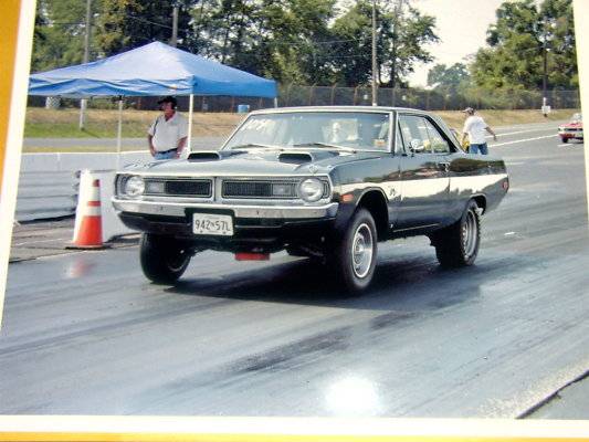

Here is my sons Dart leaving. It usually 60's in the low 1.60's with a best of 1.60 and 11.45 is its best et. Thats with the 400 bigblock and stock 318 torsion bars. Good luck with yours , Ron
