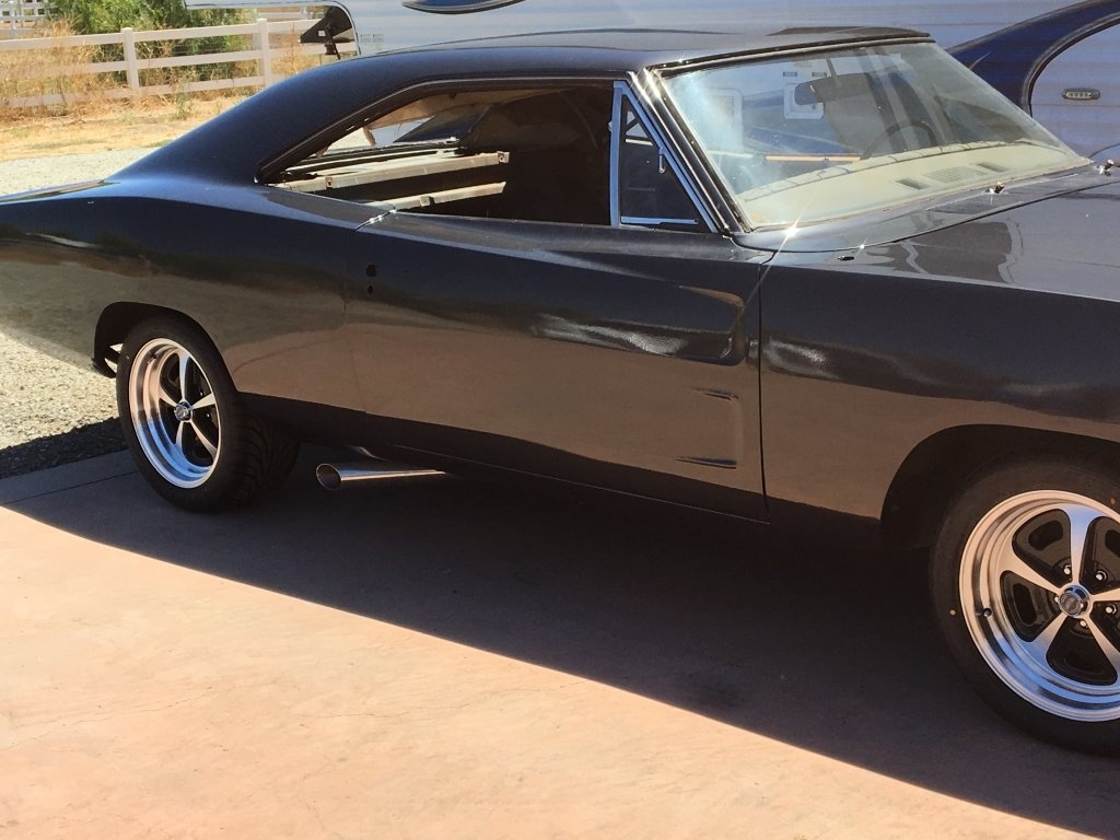

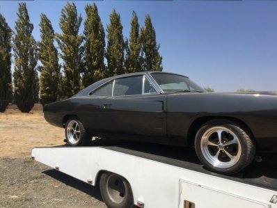

Vn501

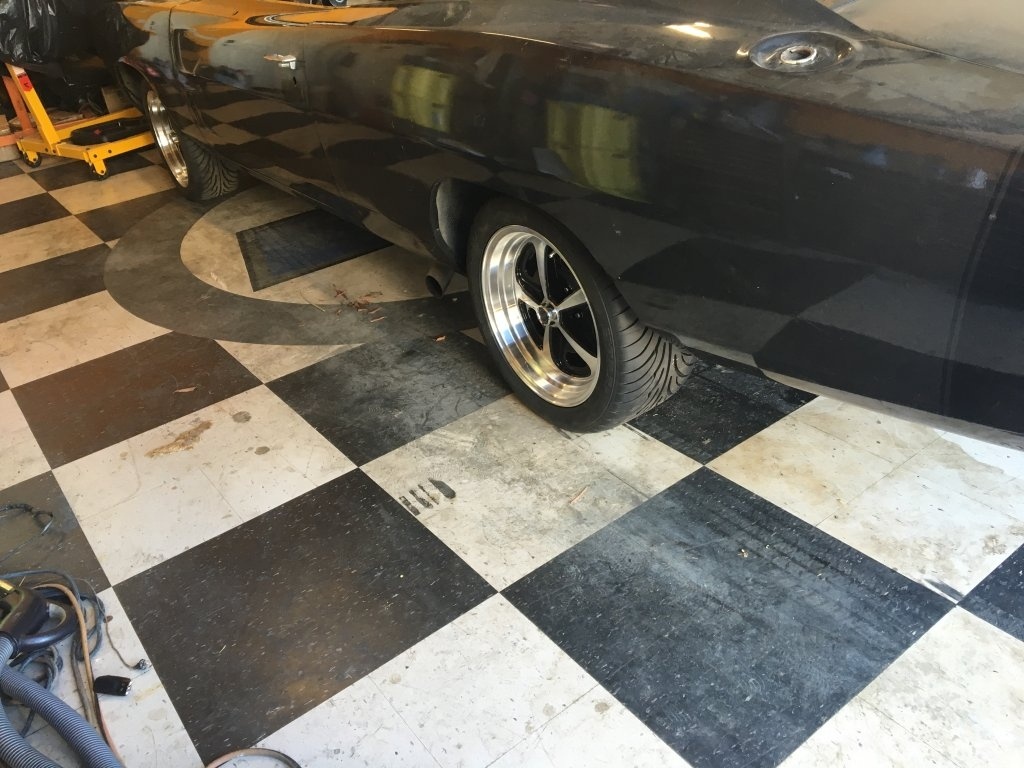

I looked into the v45 at one point. Nice rim. Bob mosher used them on a few of his superstocks so they must be good. Also have a look at ET wheels vintage V or classic V. I ended up choosing the vintage v. Super nice and good quality.

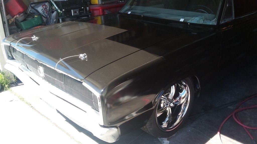

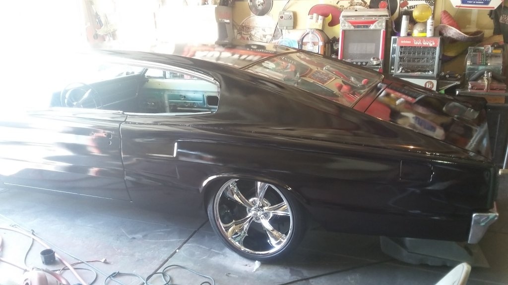

18x8.5 front 20x10 rear 5" offset fit perfect even with a 3" drop
