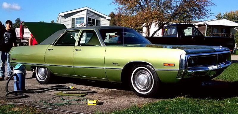

Hello, I have a 1972 Chrysler Newport Royal Sedan that I pulled from a barn after sitting untouched for 17 years with 66,000 miles on it. I brought it back to life, and its got all the desirable options (Power Windows, 8 way power bench seat, power steering, power brakes, AC, rear defroster, and vinyl top). Unfortunately it has the Motorola AM only radio. I want to replace it, even though it works fine, with a modern aftermarket head unit with FM/MP3 so I can listen to my oldies clearly and easily. Upon removing the old boat anchor radio, I noticed that there are very few wires going to the radio. And Im at a loss on trying to wire a modern one to the factory wiring. Any help?? Would like to have finished before cruise season. Thanks in advance!
