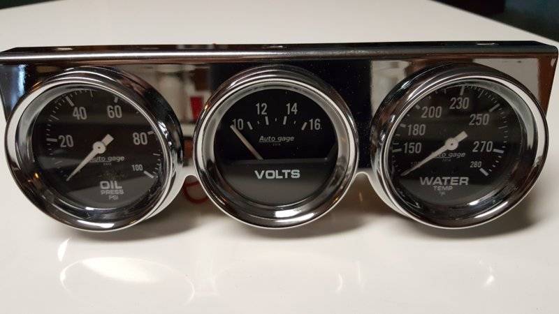

Autometer from Summit Racing are a decent price and reliable.

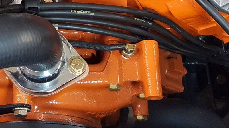

I used a heater hose port with the brass adapter for now.

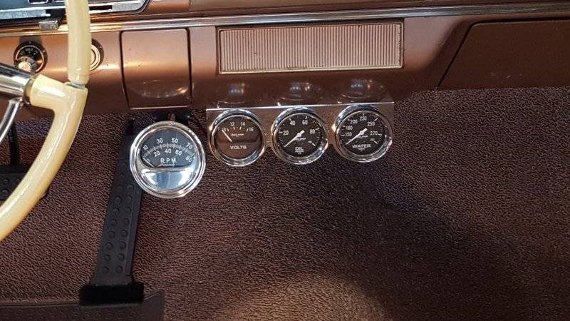

I liked the Auto_gage units..

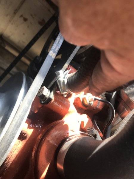

I used the plug up between the heater hoses for the water sending unit.

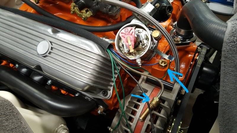

I also have Autometer and installed the sensor between the heater hoses and the radiator hose on the water pump. This is on a 383 so I'm not 100% sure your 440 is the same, but I think it may be.
