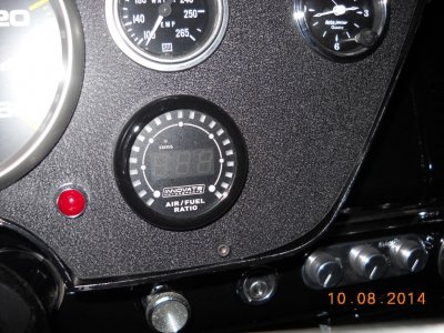

I use an Innovate Dual A/F gauge with a sensor in each bank to monitor each carburetor's function on my crossram. I tuned for a over 50 years using old school methods of plug reading, piston top coloring and highest MPH at the track. The 'new' gas has made that much more difficult. Yes, the gauges do jump around a bit, but you can definitely see how jetting /metering rod and idle mixture screw adjustments affect the A/F ratios. I find it to be an invaluable tool for getting the best out of my set-up. This picture is my first gauge that read one bank before Innovative came out with the dual one. I sold this to a member on this forum. I'll have to get a picture of my current dual gauge and post it.
