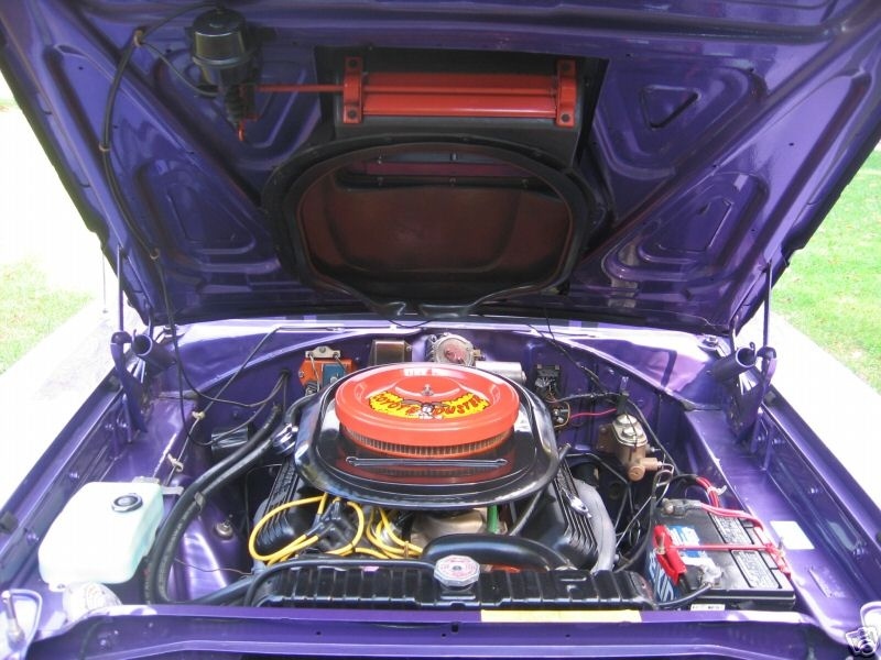

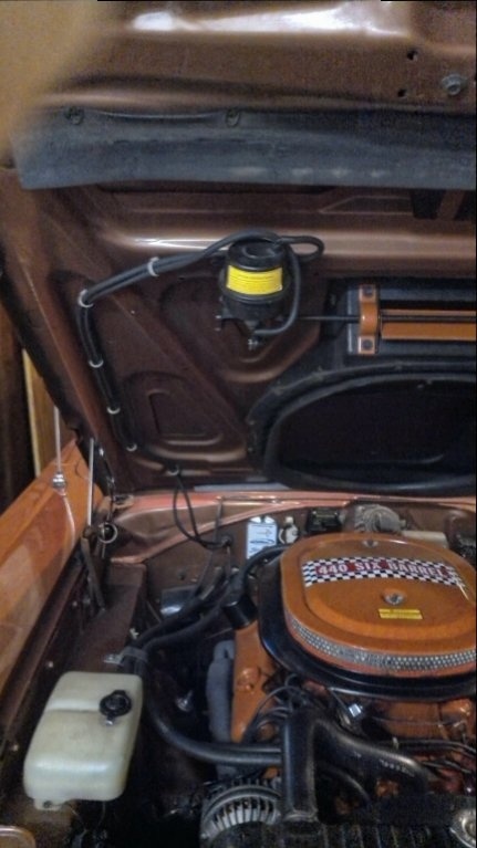

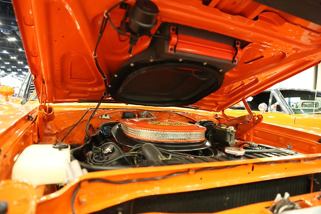

Anyone have pictures of the hose fasteners location and routing for a 1970 air grabber . Thanks
Well... I found these 3 pictures online
th
th
My factory service manual shows a '69 air grabber :(, so that's no help. From what I "vaguely recall from somewhere" I think the 3rd picture with the red hood is correct. I'm sure other more knowledgeable people will chime in. I have a couple of the original clips in my hood, so maybe I can figure it out from there if you get stuck.

Here's mine. Looks like I'm missing some clips based on 440+6's pics.

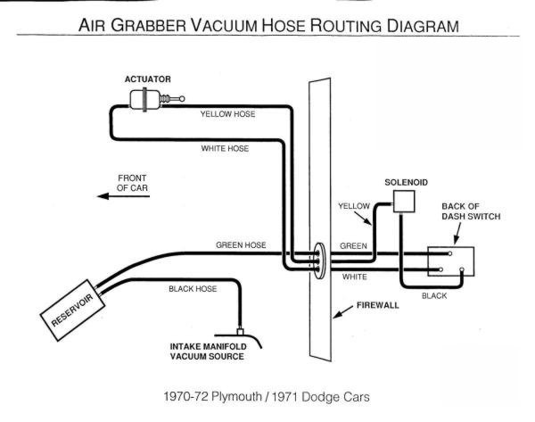

The solenoid is powered with the key so the air grabber automatically closes with the key off even if you leave the dash switch in the raised position.

Looks like I'm missing 3 clips. Anyone have any to sell? I can get a repop set of 6 on Fleabay for $20 but only need 3.
