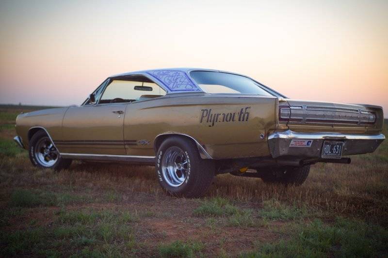

I've got 70# in mine right now.
Yeah, it's a little "stiff" in the back.
Not terrible, though.
Raised about 4 inches.
There is some rear body roll because they are plumbed together.
Separating them would allow them to not roll as much and also could be set up to work as a "poor man's limited slip".
...but the sacrifice is having to monitor each side, rather than just airing them until you like the way it sits.
