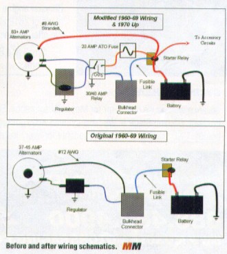

Well My New Mopar Friends , The Pulsing Lights Are 95 % Gone Due to 2 permanent solutions 1 Ran a line directly to the hot off the starter relay to a bosh 30 amp relay that is also connected to the ignition switch that goes directly to the voltage regulator which bypasses the bulkhead connector and the amp meter ( which cant handle 325 amps anyway ) ran 12 ga for all this then still was pulsing a little thought about it over night realized what else is missing then it hit me (after the voltage regulator to the alternator ) so i replaced with 12 ga from the regulator to the alternator now voltage is 14.1 all day and pulsing of dome light (as a reference) is gone im also putting up pix and thanks all if any body has more input on the matter please let me know Mopar Wiring August 29, 2013.jpgMopar Wiring ,, August 29, 2013.jpg

Yes i did find the answer. Wire and bulkhead connectors are 45 years old. Wire is brittle and poor connections at bulkhead connectors this eliminates all that to two connections batt to regulator plus amp meter only good to 45 amps at best anyway im running a 325 amp alt
