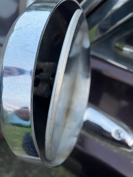

Also the door mirror on the driver side is floppy and wont stay in any position at all.it is remote controlled with the cable operated "joystick"inside.
Any idea on how to keep it solid even if its in a fixed permanent position?

I was able to disassemble one of my mirrors, and put small washers under the spring to tighten it up.
There are things called "barrel nuts". They push into the trim hole, and the trim studs push into them and are secured tightly. The mirror may have a broken or unattached cable. The door toggle works 3 small cables to adjust the mirror. You can unscrew the toggle bezel, and push the toggle out. Then the door card needs to come off. You can reach up into the door to remove the nut off the forward attaching stud. Then you can remove the screw from the mirror base, and remove the mirror and cable as an assembly. From there you can discover what is wrong. If your mirror is not repairable, there are reproductions available.

can i somehow tighten up this mirror through this gap without removing it?
Nope, but it's pretty easy to remove and open up.
