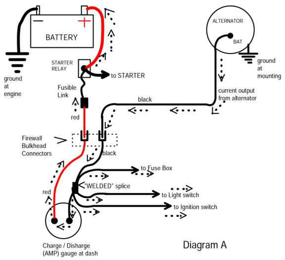

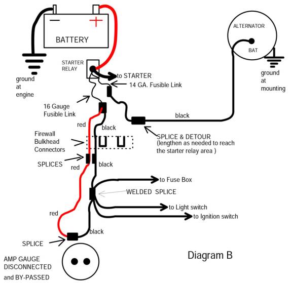

Here is the MAD electrical diagrams. FIRST is stock:
The following is the modified version.
Properly troubleshoot the voltage drop, by-pass the bulkhead charging system terminals, the real weakness in the original design. Check the ammeter connections, make sure they are not loose or have damaged insulators then leave it alone. Make sure all loading is on the alternator side of the ammeter, not at the battery.

I have a stock set up on my 1970 Satellite. I plan to bypass the Alt and use the Mad schematic. I’ve researched this well on this site and the Abodies site.
Question: Is there any better Ammeter bypass set up or are most in agreement that the Mad set up like what KD posted is probably the simplest and most effective circuit change? There is so much material written out there…..

Do you mean by-pass the ammeter? Did you read the Mad article carefully as to what vehicle type it was intended to address? You read all the ammeter/charging system threads here and concluded the Mad Electric approach is what everyone recommends?
Bypass the bulkhead connector charging system terminals, check the connections at the ammeter for loose or damaged connections/insulators then leave it alone, make sure all vehicle loads are on the alternator side of the ammeter as originally designed.

Every Chrysler product built with an alternator and an ammeter in that era. All factory loads are on the alternator side of the ammeter originally, one exception, the starter motor. See Diagram A in post #4 above.
With a stock system, any add-on loads connected at the battery draws its current from the alternator while the charging system is in operation. Places all charging system connections between the battery and alternator, including the ammeter, well outside of the original design limits and registers as false charging on the ammeter.

Yes bypass the ammeter AND bulkhead connector for the feed into the cabin.

I won’t enter on discussion about the ammeter conspirancy “myths” and stuff… many threads about that around, but in my opinion: You can get a power decay and save the battery volt level with that bypass, but the main splice is still into the cab running throught the bulkhead, SO, the power decay ( maybe reduced but still present) will be still affecting all the power being spreading up from the main splice.
stop running patches but fixing, getting mantenienced or upgrading the real deal.
