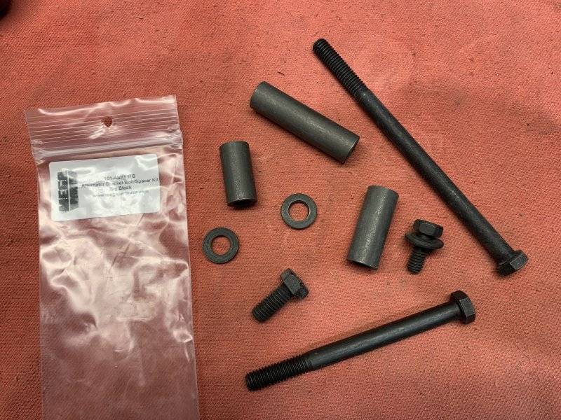

Not looking to buy but looking for the length and thread pitch of hardware needed for a non ac alternator bracket to align it correctly. The po used a cut off bolt with a nut and just need specs to align it, any and all information would be greatly appreciated.
Bought this kit from Megaparts…just got it today! I prefer the phosphate bolts over 440 source.
Spacers measure as follows…
1.231
1.560
2.354
Hope this helps!
