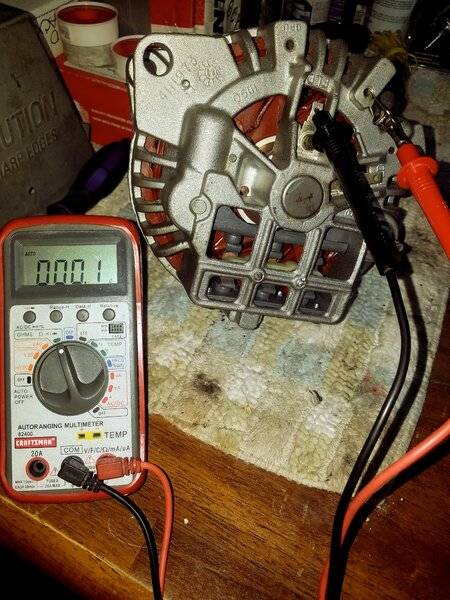

So with Electronic Ignition Year One send out a 2 wire (Blue & Green Field wire) harness.. My alt which is new/ Rebuilt, does not charge. So got out the voltmeter. Did a couple of tests. In the past, the green wire was always attatched to the tap nearest the TOP of Alt. Furthest away from BATT termninal. Reading 00.1/00.0 Ohms,

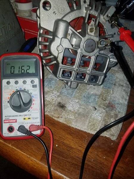

the 2nd tab obviously has 16 Ohms!

brush grounded to work like a single field alt or it is somehow shorted... If you test both prongs will get same 16 ohms measure... or close. Both prongs must be completelly isolated from chassis and no measure againts it. Just get the rotor impedance between both prongs.
I think 16 ohms is way too much though. It should be more like 5-8 ohms as far I recall ? can't remember

What I told him yesterday Nacho... where he is hooking up the Blue + wire is grounded to the case and why he's frying his blue wire as it's a dead short. He needs to get that spade connection isolated from the case, but of course it shouldn't have been grounded out in the first place if he wants to stick with the two field system and the electronic regulator. It would work just fine on a single green wire system...
Yeap. But a dead short should already melt down the wire somewhere up to get smoke! Or blow the fuse link. I have been there. My car didn't have fuse link but a regular wire when I got it, the brush got accidentally grounded and melted the blue wire cover up to the cluster! ( standard cluster gets the blue source to the PCB ). Had to replace all the wire and some others around it.
