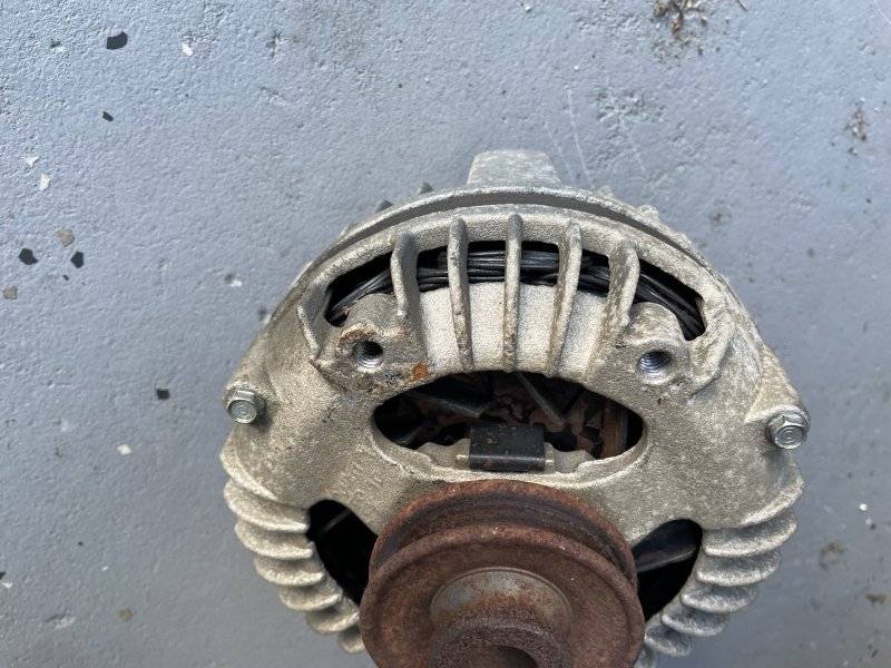

I’m looking to buy the bolts, nut, washers, and spacers to mount my alternator. It’s for a 1972 318 non AC engine. Please let me know if you have these. I attached pictures.
None needed [spacers]. I believe that alternator mounts directly to that mount. One long 3/8 bolt nut and washers along with one short 5/16 bolt, flat, and lock washer. All common hardware store items. That is an older style mount like 1969 or older as I recall. Here are some kits. Electrical, Alternator Brackets :Mega Parts USA
That is a 66 mount which works with the cast iron water pump. Looks like that’s what u have. 72 has a different set of mounts. That work with the aluminum water pump 1970 and up Bottom hose is on the passenger side. What car is this going into. Kim
Thank you so much for the information! It’s in a 1966 Plymouth Belvedere.
Thank you very much for the information! It was very helpful, I just ordered the bolts.
