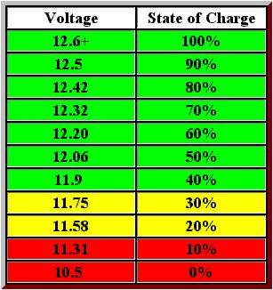

Wait, a fully charged battery is 12.6v (2.1v per cell).
Well, that's a pretty little chart. But it ain't right. Modern batteries are well over +13 volts when NEW and FULLY charged. If you only have +12.6 volts and its FULLY charged, then that battery is OLD and about to FAIL on you.

12.6v IS the correct number for fully charged standard lead acid automotive batteries. Some gel cell deep cycle battery manufactures list 13.0-13.2v as fully charged.

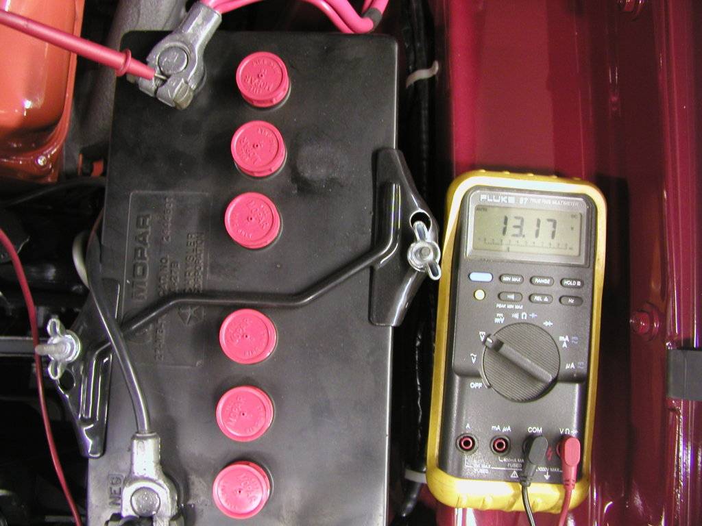

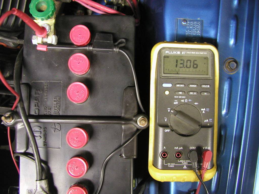

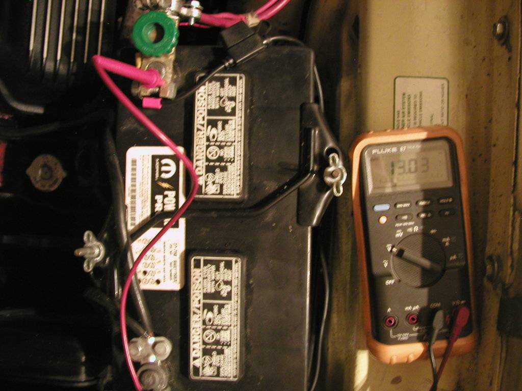

Believe whatever you want to believe, fellas. You're quoting "theory" (which I'm well versed in) not reality which is what we live in. Oh, just found these in my garage a few minutes ago. What should I do, return them as defective?? Too much voltage?
Just an FYI, these 3 batteries are 4 yrs, 5 yrs, and 7 yrs old. Not a damn good one in the bunch, according to theory and Wiki (oh, and let's not forget Design) they should only be +12.6V MAXIMUM.
Well damn, there goes 45+ years real world professional automotive experience and training down the drain. Those numbers sure look to include the slightly elevated voltage resulting from surface charge. How much time went by after disconnecting from a battery maintainer/charger, and what steps were taken to dissipate the surface charge prior to taking those readings curiously?
