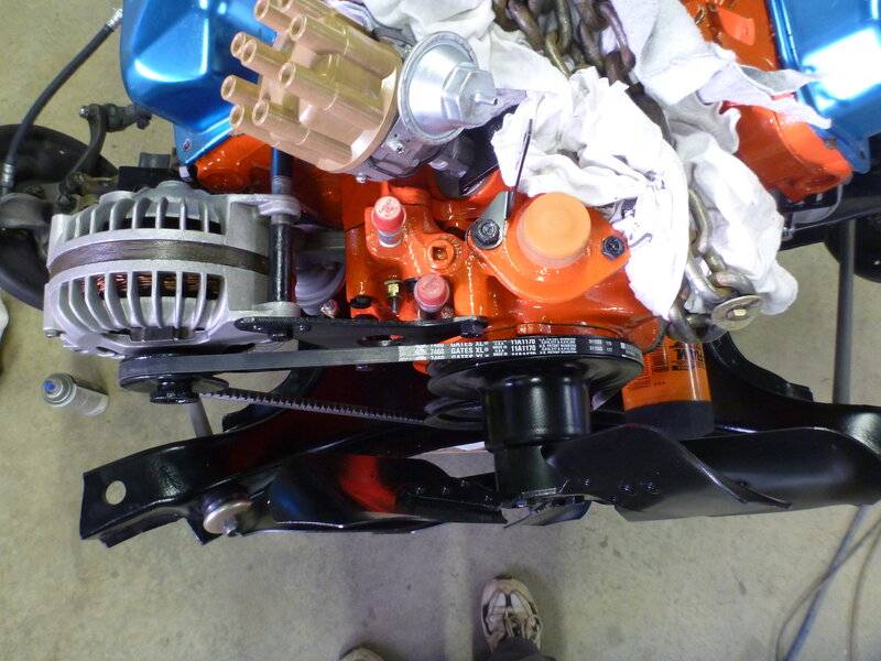

THANKS to all! Yes, Sirs and Madames, i am off to our local mega hardware store to buy a cheap spacer, even if I need to cut to length! Dadsbee thanks for the very convincing photo!
