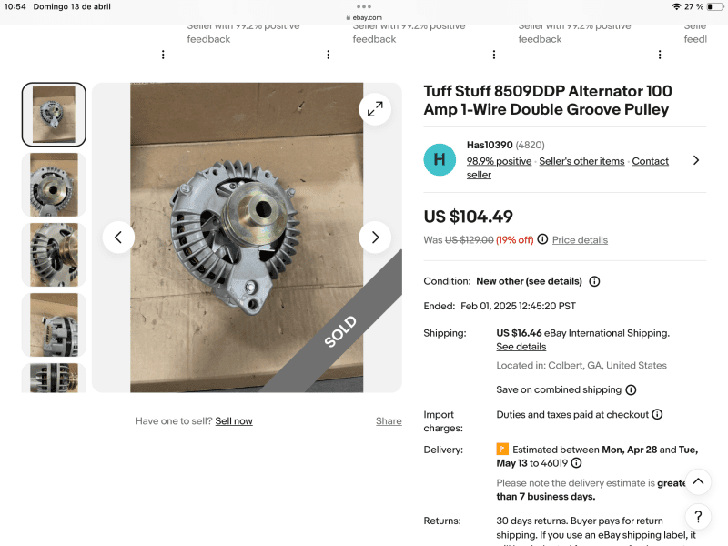

Go to Tuff Stuff and find the one you want on stock casing (based on the first squareback alt version which is the one you have)
Chrysler alternators
They have 60 amps, 100 amps, 130 amps… cast finish, chromed, black finish. Stock dual field, one wire…
If A/C, they have single and dual groove setup made with the small pulley (later) version, able to hold better the load supplied at low RPMs
Aside this and noticing you are proceeding with some other upgrades (per the rest of your threads) I would suggest upgrade to 100 amps alt which are able to hold better the power at low RPMs, very critical to sensitive ignition systems… but that’s my opinion. Couple of upgrades on alt/amm paths and voilá
MAYBE this is the one you could get, which is the same I got couple of months ago, not in hands yet but at a friend’s home. Waiting to be overseas shipped yet maybe at the end of the year.
But I will remove the attached regulator and will change the brush to get back the field prong for the dual field setup. I don’t care the one wire setup. Just got it for the price. (Was on the hunt for years untill find it affordable to me). Description said mounted but never used.
