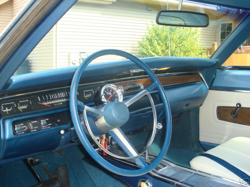

on my inst cluster there's a guage labeled "altmeter" assuming alt is short for altenator. I believe it reads amperage.
got any pics of it?? on mine it says alternator...
then you have answered my question rgaz thank you!
I recently changed over to electronic VR, I've got good ground and clean termanals everywhere but the system is not charging. that gauge is the only thing I can think of that's not working.
