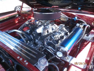

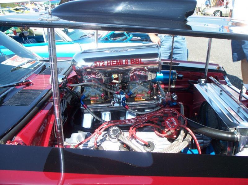

I Called keith black two weeks ago about there HEMI and he said they were about 4 to 6 months out on there blocks.
