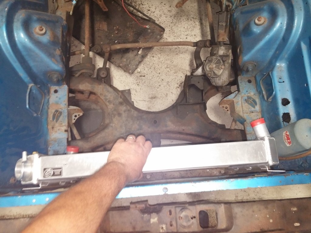

I believe mine is 26", I set it down in the bay and it looks like a perfect fit....I'm still trying to decide if I'm going to push or pull mount the fans....Looks like they will clear either way. I'll measure it this weekend when I go to the shop.

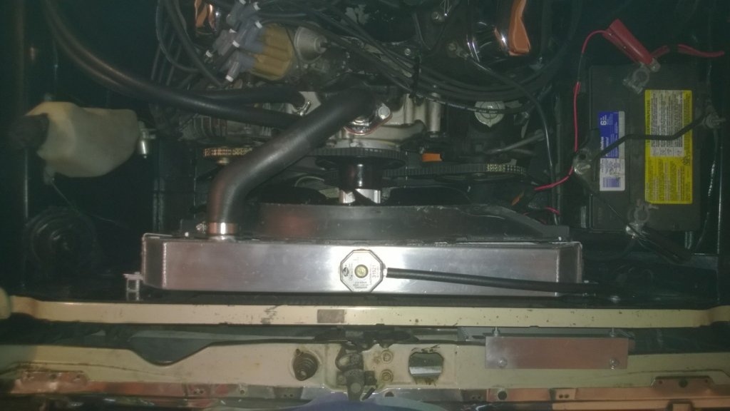

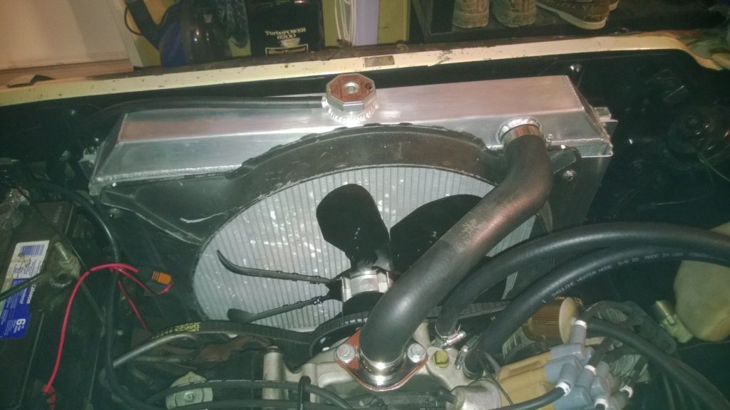

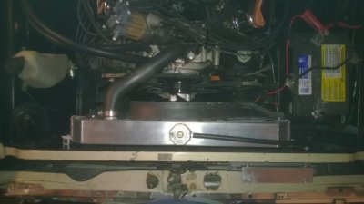

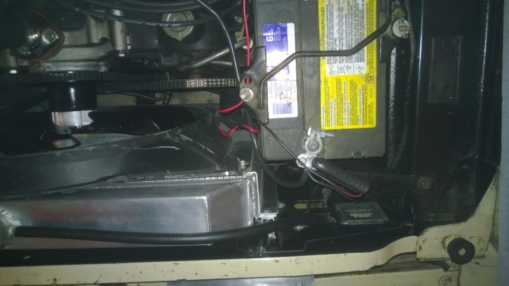

This is my rad install. It was in the car when I bought it, I just installed the stock plastic shroud over last winter. I am not sure of the rad brand but looks very similar to the Champion above. I am thinking about painting the rad black at some point. The car is a 66 Belvedere with a 727, stock battery location, external trans cooler on the front of the rad. There are 1/2" square tube aluminum spacers between rad support and the rad. Hope the pictures help. Sorry about the foggy images, must be pocket lint on the camera lens.

I put a 26 inch rad,aluminum, in several 22 inch spots. I used Champion direct fit(for a 26,lol) and worked excellent..easy to install.
