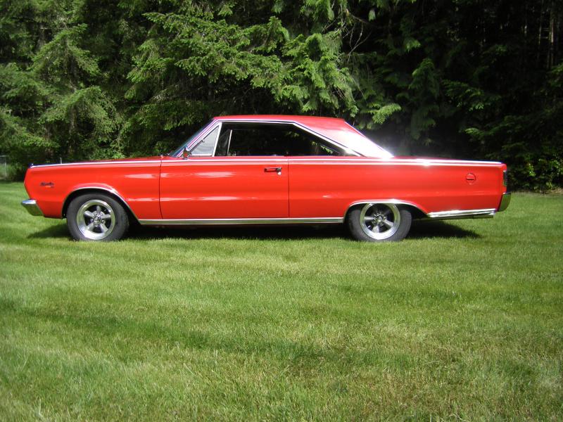

Polish it and protect it with Sharkhide sold by Eastwood. Google Sharkhide. Its what I used on my 66 Satellite trim and wheels 3 years ago and still looks like new. STH72713.jpg

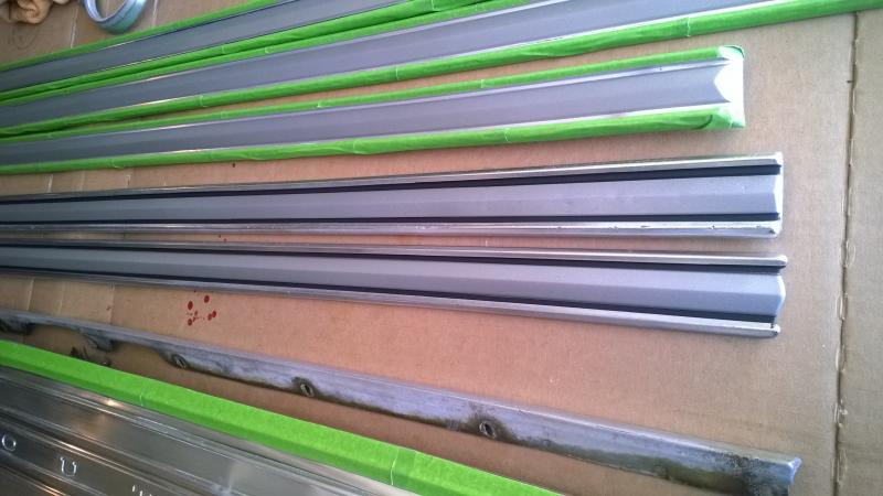

I used paint remover to get down to the original anodize, hand polished and for the 66 bel rattle canned the black pin stripe and used metallic nickel paint in the center strip.WP_20140915_17_58_48_Pro[1].jpgWP_20140928_09_11_55_Pro[1].jpg

The paint remover did not affect the anodize, It removed the striping and overspray form previous paint jobs. After use of the paint stripper I found the center section of the moulding to be shiny and still anodized.

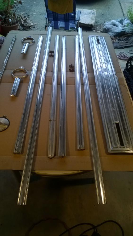

You can bank on what Zack says about dealing with trim pieces. He restored mine and they look great!
Yeah they do!! Looks great!
