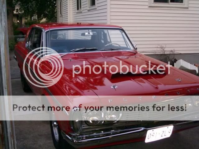

What about a fiberglass scoop ? My Max Wedge scoop was given to me from a friend and its a thick fiberglass. Its very strong and works good. Ron
