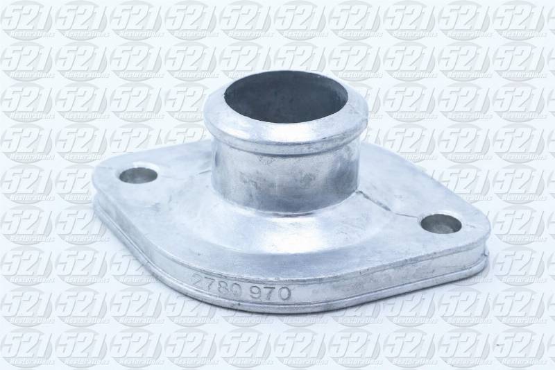

Someone experienced problems with a Mopar OEM 2780970 Aluminum Thermostate Housing.
And please do comment if you think there is no ploblem with this part...
Picture is for your attention.

A picture of the housing you are talking about would be helpful.
Well, I don´t have a picture of said thing and can´t see how I can be more specific than mentioning
partnumber and all.
If you know you know I guess...

No problem here. I had originally used a Billet housing and it warped in no time. Started a thread on here and member @Cranky sent me a used oem part # 2780970 and its still doing good after almost five years.
