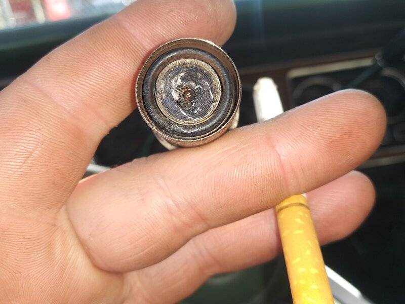

So i found the fuse that was causing it. If the fuse goes again am i on a goose chase for a short in the brake switch wiring?
Chrysler came out with a way to entice people to stop smoking in the late 70's. If using the grit lighter it would cause nasty electrical problems...

Held the lighter in for about 45 seconds while i was distracted, talking to my buddy after work. Melted the damn thing together.
