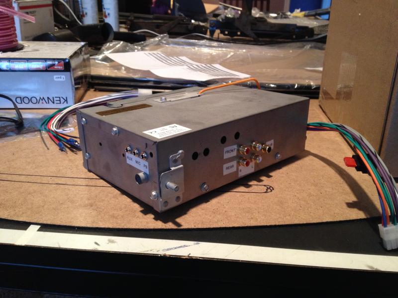

There are a number of places that sell or convert radios so they look like original radios but they have high power and AUX capability. I had my AM radio converted - see pictures below. You can also buy the radios outright - here is just one example, but there are many styles available: http://www.classiccarstereos.com/category/Plymouth-Roadrunner-Radio.html

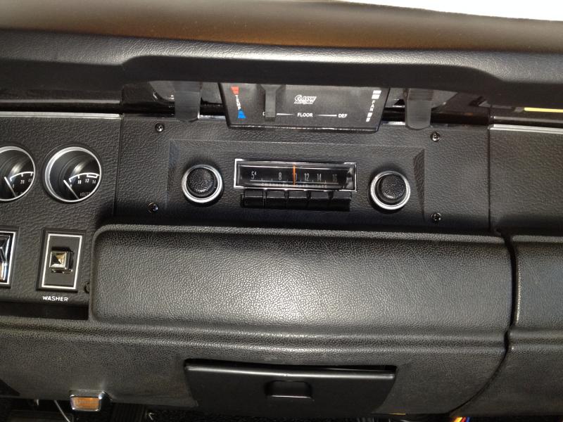

This is my radio and now has full speaker outputs for 4 speakers, high power (with subwoofer), line outputs, plus aux inputs and Bluetooth capability with a microphone and hands free capability...
...and yet it looks like this.
