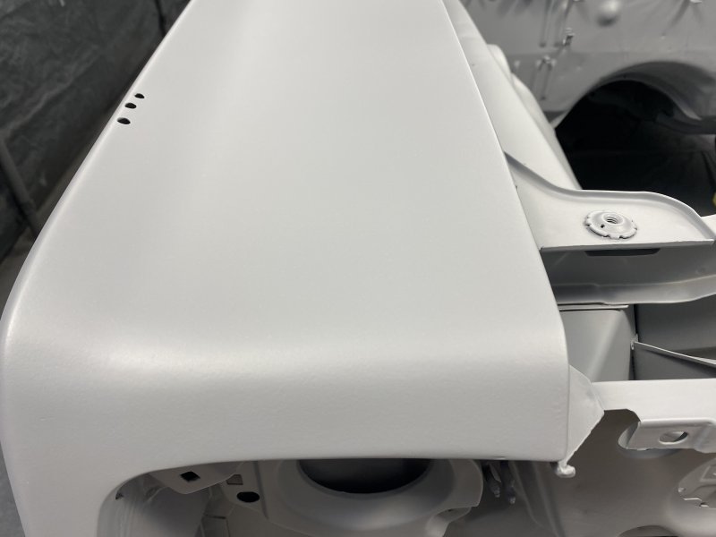

I’m working on restoring the under hood and front clip on my car. Everything went to bare metal. I used Kirker Enduro Epoxy DTM prime with their activator to cover the steel. Moved on to small amount on plastic work. Then used Kirker Perfect Prime with their activator again. So far so good . I went apply a second coat of primer today and the cowl started to wrinkle as it was setting up, looks like the substrate below started to shrink and wrinkled the coat.
Only comments is the Epoxy DTM primer never seemed to get 100 rock hard. They say on the label it takes up to 3 days to fully cure.
So what did I do wrong and what do I have to do to remedy?

I just sent the Kirker rep a bunch of photos let’s see what he thinks happened. Everything else looks fine no negative reactions and flowed out beautiful
I think if it was the epoxy coat, you would have seen this on the first coat of Perfect Prime. So the first coat of perfect Prime must not have cured completely, the amount of hardener was off or temps got too cool in the garage. A temperature of 60 degrees minimum is usually OK but curing does slow down. But yes, I think you will have to take the area back down to at least the Epoxy and possibly all the way to metal.
All that crazing on the first pic makes me think also something wasn’t prepped right. You remove all the old paint or wipe it down with prep sol or wax and grease remover before primming?

first pic!

I was wondering if there was residual solvent that I use to clean the gun after each use. That area that reacted was sprayed first. I just wonder if I sand it smooth again if I can hit it with a sealer and be good?
That is a bummer - it just sucks when you’re getting to that stage and this happens. I feel for you! I think it’s very unlikely you will be able to sand it smooth and try to re-coat. I’m in the camp of probably going to have to bring it back to bare metal.

Sorry, but all that needs to go back to bare steel. Could be several reasons why that area wrinkled/lifted. Just go back and follow product directions on temp and mix.
