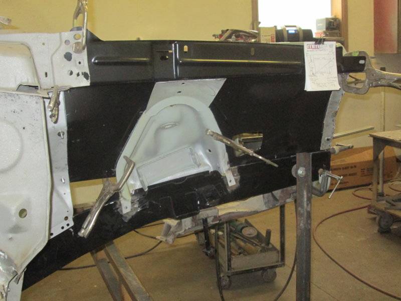

Hi guys replacing complete frame of 70 charger .I find out from some where that AMD front frame is 2" short from where it connects to crossmember.is that true? Did any one had problem with it?ple ple let me know as soon as possible cuz I am on process.

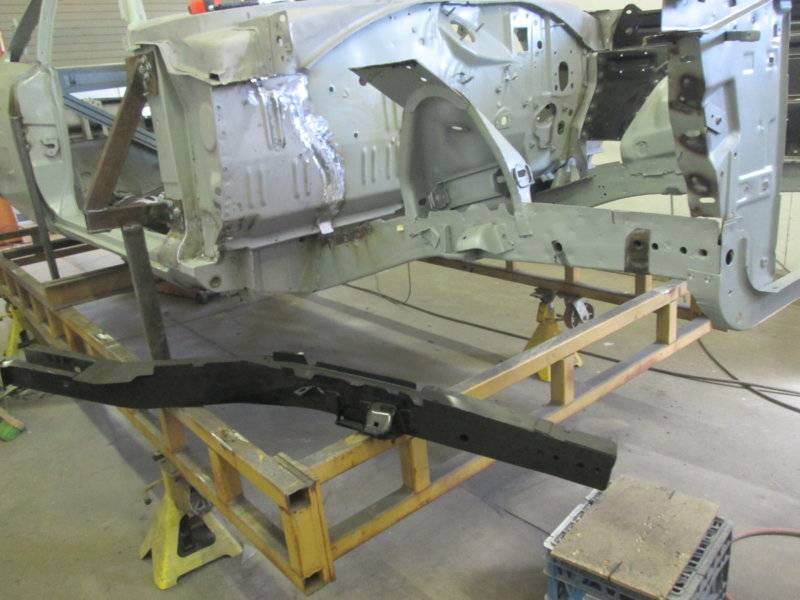

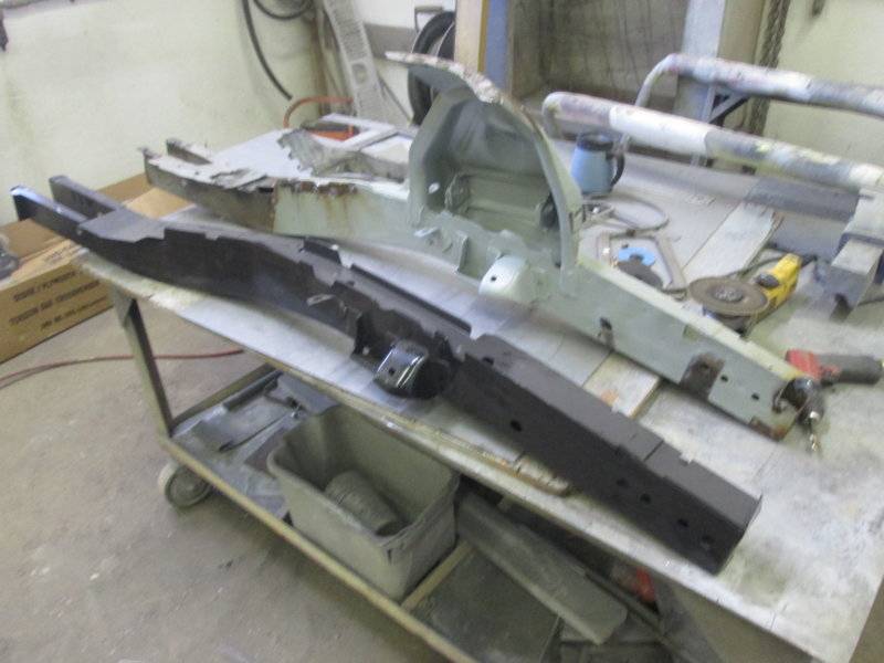

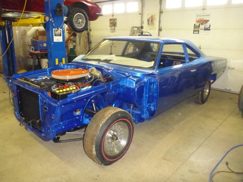

Nope... fit perfect.
beeresto2016bodyshop 632.JPG beeresto2016bodyshop 650.JPG beeresto2016bodyshop 692.JPG beeresto2016bodyshop 695.JPG beeresto2016bodyshop 698.JPG beeresto2016bodyshop 238.JPG

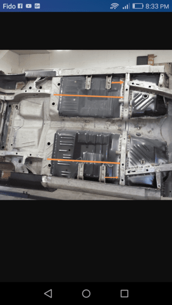

Plz if I can get this mesurement I am doing easy way.
Sorry, can't help easily with the #'s.. that was 2 years ago and mine's a '69 (although they're probably the same). I'm deep into reassembly now. Maybe someone has theirs still open, but if not I can possibly crawl under mine if you don't get some answers.

Thx Budd no problem.if you think it's not difficult can you give me the mesurement from the center of shock tower hole till the firewall both sides please?I think that will be easy one.

What hands on info makes you say this Rick? We could find no major discrepancies from my stock rail to the AMD that we were replacing it with. Was easier to do the entire rail than bother to fix the cracked one I had from dumping the clutch a zillion times each night as a teen. Now if we hadn't been into cross member and floor pan we would have fixed the rail, but with what we were doing it was a no brainer to go replacement.

Impossible to measure the drivers side with booster in the way! That said, both my '69 and '70 are 15" +or- a 1/16" on the passenger side and eyeballing the drivers side appears the same.
Underneath BOTH cars, my original Bird and my repaired Bee are 46 5/8" from rear face of crossmember to the front edge of that rear frame hole.

Thanks alot I am getting same 46 5/8

I was comparing my old mesurement with original one so I checked now I am going good with mesurement.thanks alot guys for help.
