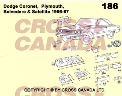

Donars are hard to come by,I hardly even see any 67,s on the street or car shows.I know cross canada has some panels but are poorly made.I guess I,ll try to use them,I can,t make it any worse

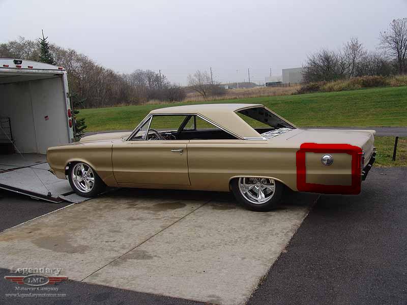

I know for sure I have a good passenger quarter but would need the lower rear patched but teh complete upper is fantastic (lower 4" is rotted)
The drivers side is fantastic at the bottom but up farther was damaged by the prev owner so that would be a great lower - mid patch panel and of course I can cut off what you don't need to make shipping easier and cheaper.
And I will price these way below what you normally see these for...
quarter
The worst part is here,has 3 patches to make one,let me know how much you need and do you have a pic
pic

thanks anyway,I,ll probaly use the one they sell from crosscanada,is not great but is big enough to try and make it work
