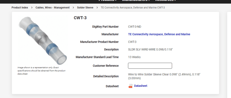

#8 #12 with a low temperature solder butt splice should work OK.
Something like this style:
