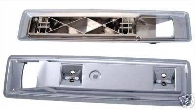

As far as the Plastic chroming, a few plastic parts on our old mopars are chromed like arm rest bases, dash bezels, door lock knobs...ect..ect..
The process does not involve paint applied to the plastic, but rather a more robust vacuum sealed coating..
Looks like this:
