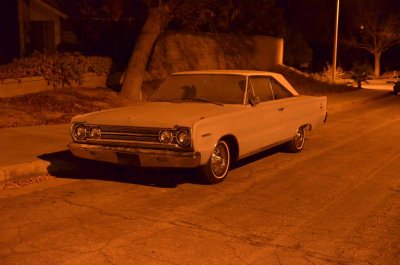

My latest Craigslist find. 67 Belvedere II, 383, TF, don't know rear yet except it's an 8.75. Bench seat interior. Carpet is missing, but I could see the car had some surface rust, and nothing is rotted through!
