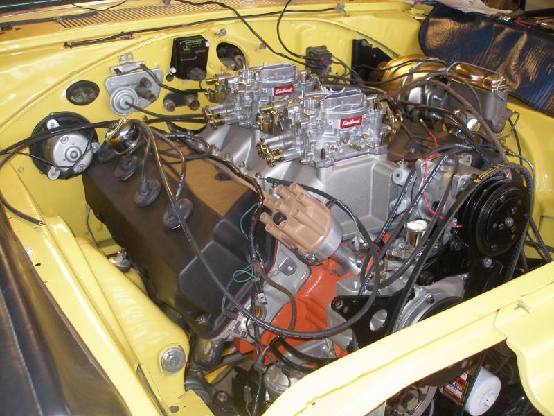

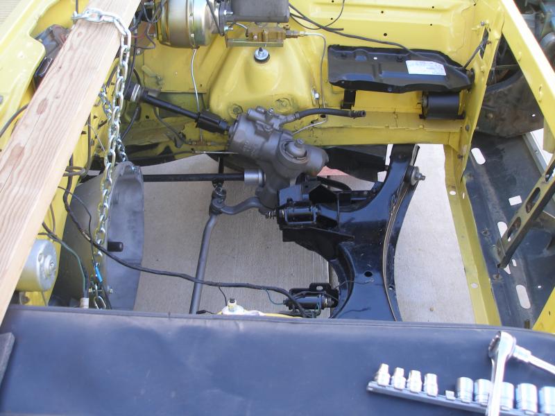

Yeah, I used the Mike Schumacher mounts. Check the motor mounts out in the pic below. They work great. I did add the protective plate to my K-member just as the factory did. Get it from Bob Mazolinni Racing or Mancinni. I order EVERYTHING from Bob Mazolinni Racing. (I like Bob, NHRA record holder, local here in So Cal, has Hemis all his life and he's quick to ship). Anyway, this plate protects the Hemi oil pan. I also "beefed-up" my Superbees' 727. I ran the TTI headers and the only trouble I had was (is) the new trans cooling lines from "Fine Lines". Boy, they are sweet BUT hard to bend in the back coming off the 727 trans and as they go forward past the convertor and headers.
This is a good time for you to Powdercoat your K-member too.

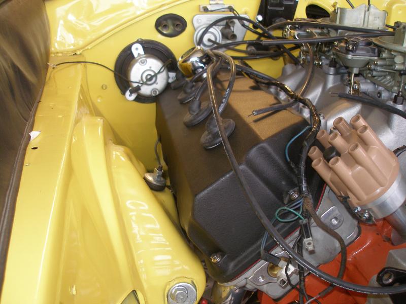

Clearance issues for me were the Stage V heads being larger than the "Mother Mopar" heads and almost touching the Air Conditioning blower motor. See pic below:
WOW! That's really close to the shock tower.
I love those valve covers. Who made them?
Great looking Hemi by the way.
Hi,
They are Hansen Stage V valve covers as is the heads and intake. a "better head" than Mother mopar. Thanks "Streetrebel"

The Schumacher mounts are the least expensive way to go, but they raise the motor higher than stock so you may run into other issues as stated above like shock tower and master cylinder and I would think would not work with factory fresh air induction sytems. On the other hand, a hemi k member is quite expensive. I have seen quotes as high as $1500 to modify your big block k member for the hemi. I was lucky enough to get one from a friend who had picked it up at the mopar nats a few years back. I still had to make some slight mods to the factory hemi brackets to get the TTI headers to clear my power steering box. Either way you go there are trade offs. Just do your homework like you are doing now and you will make the right decision for what works best for you. Just my $0.02
