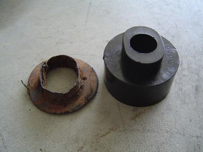

Question for those that have replaced their k-frame and torsion bar mounting bushings. The new sets i have came with inner sleeves, but what did you do regaring the outer sleeves?
Mine are completely destroyed, rusted, and not useable. Was this only a requirement for the original rubber ones or do you need these for the new urathane bushings?
here is what i am referring to, and one from the K-frame.

I'm trying to think where that fits?
Is that part of the bushing?

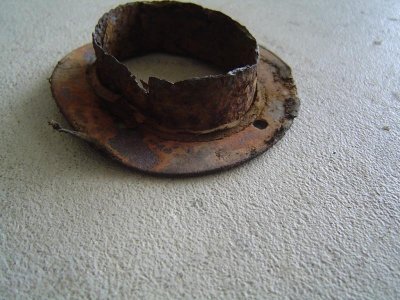

Because the torsion bar mounts directly to the Lower Control Arm (each lower control arm) scoket.

yup, I remember; (I think)
Throw that away, that WAS part of the old bushing.
When I pressed mine out, the bushing came out of it's sleeve.
I'm almost 100 percent certain the new bushing comes with that outer housing.
Hey super-bee hes refering to the iso suspension on 73- up cars. And as for the sleeves. Ditch um, you dont need them.
Thanks everyone! There were no outer sleeves with the new bushings, and i just wanted to make sure it was part of the old bushing setup. Cool. I just have to smooth out those openings a bit so they dont wear into the new bushings.
