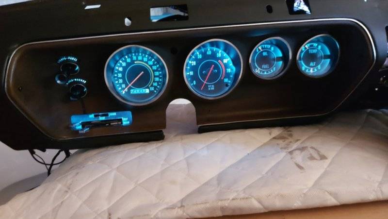

I used the cool whites in my dash but kept the factory blue diffusers in pace.
Here's what it looks like...
