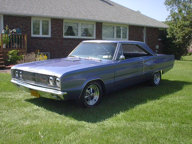

I put mono spring(calvert) 1 inch over and my 3600 pound R/T sits very nice IM000906.JPG
