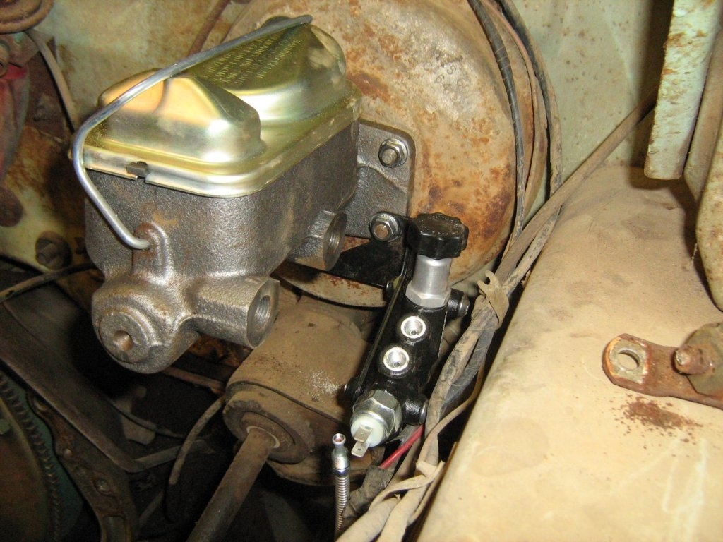

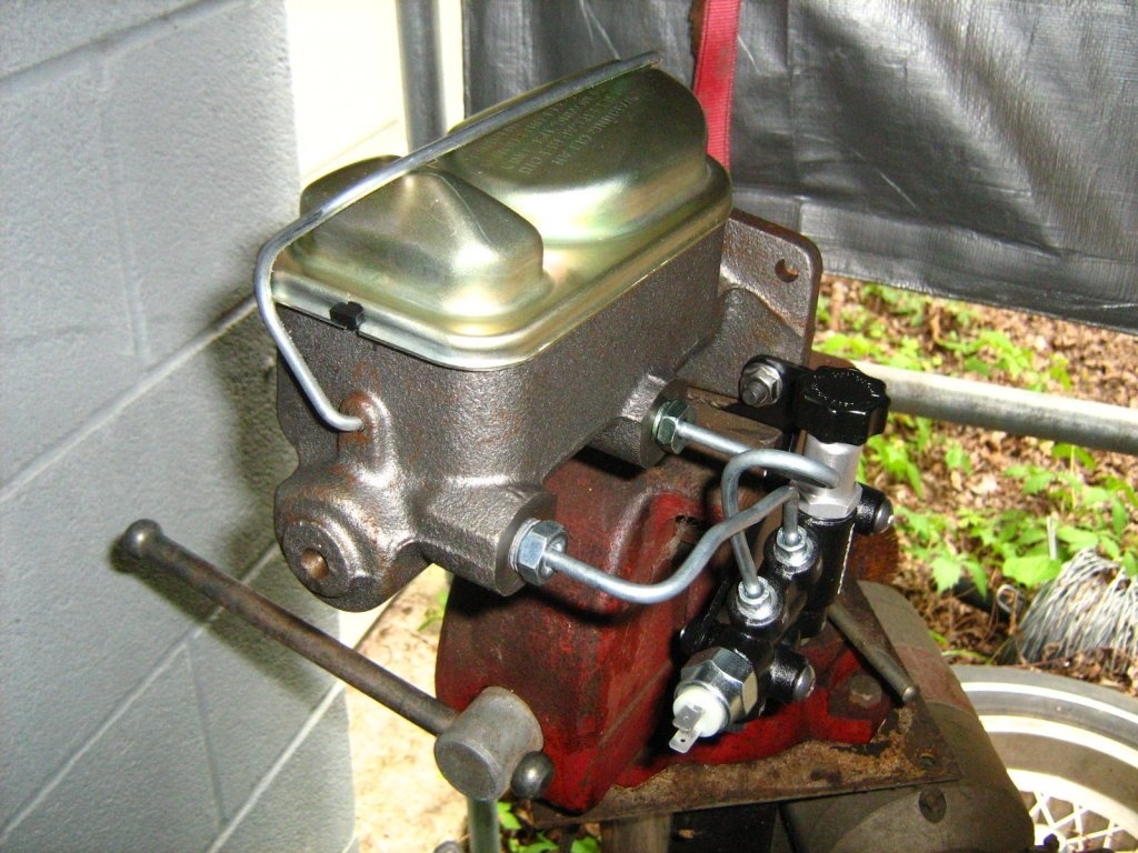

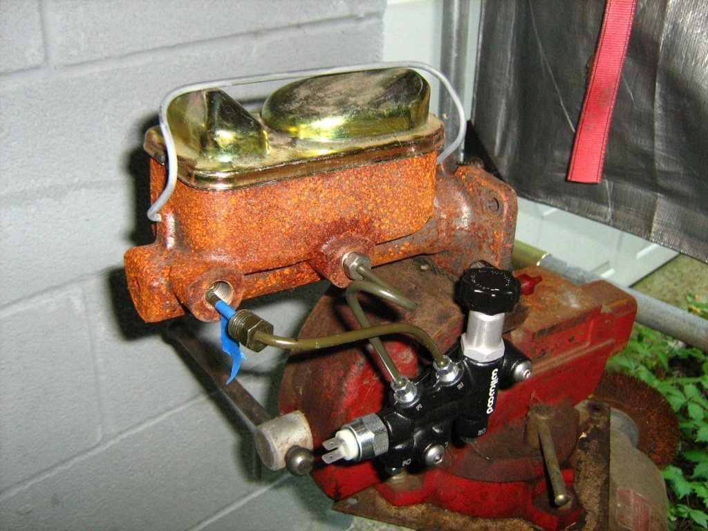

I used the SSBC conversion on my 65. It has an adjustable proportioning valve installed to the rear brakes.

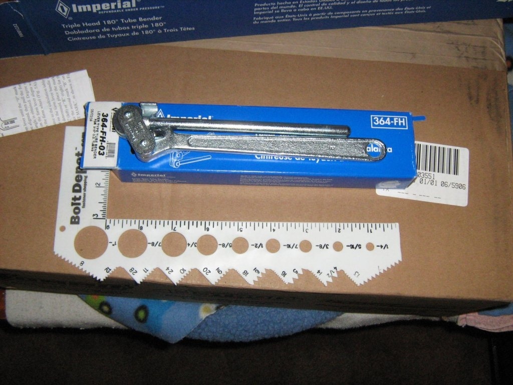

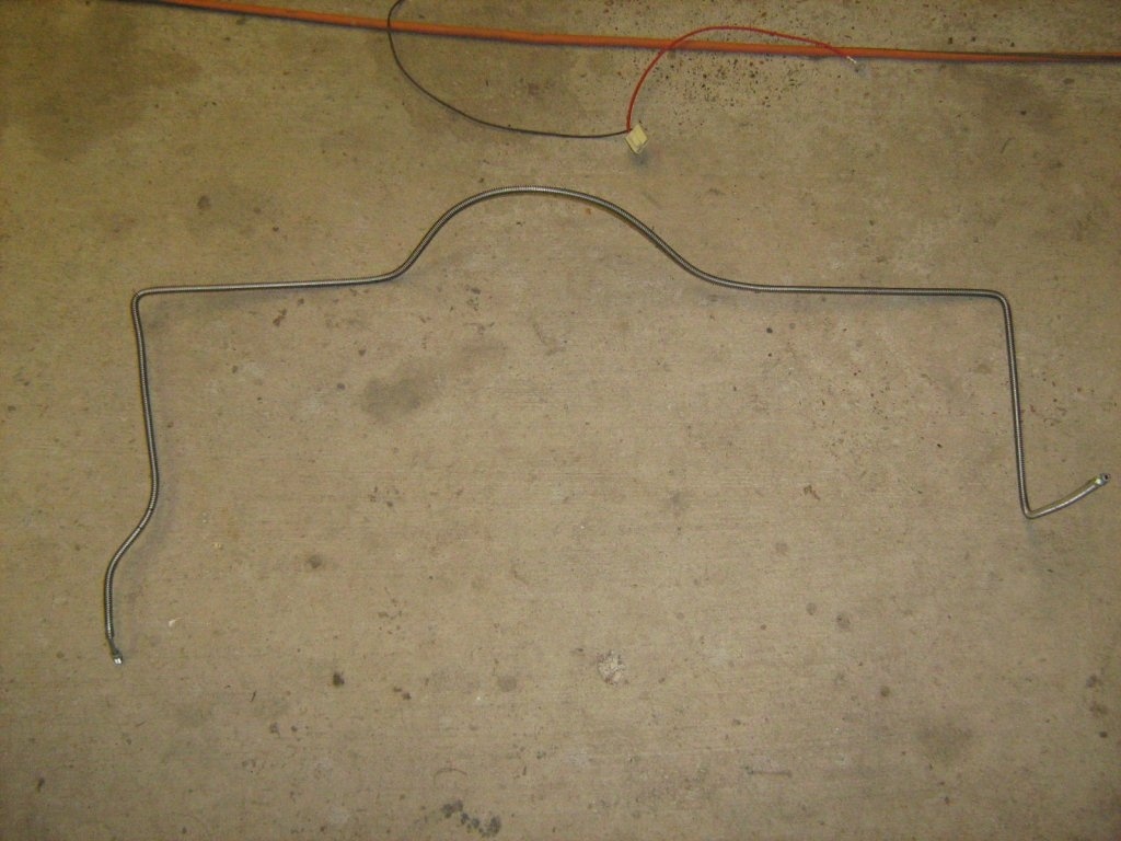

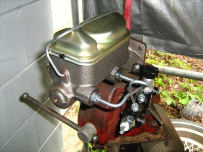

I too used the SSBC on my 65. I used its master cylinder, but not the brake valve. Why? Because the more fittings you have the more likely you can have a leak, also unsightly. You will have to bend new brake lines, no matter how you install the valve. I pray that your motor is not installed, just makes the passenger side line easier to make and install. Do not forget the wire wrap where the lines can be seen(Summit)
Summit Racing® Armor Line Guards. It helps make a better looking package and protects the new brake lines. Avoid using SS for the lines due to being harder to work with and leaks. Also buy a tubing bender for the 3/16 line, it works like a charm. Wilwood valve.
edit: beware that Mopar used its own brake size fitting on master cylinder- included with the SSBC kit-if you removed it from the line.
2014-07-25-2 3-16th tubing bender.JPG 2014-08-15-1.JPG 2014-08-07-2 Coronet master and lines.JPG 2014-08-19-3.JPG 2014-08-07-3 Dons master and lines.JPG
View attachment 412830 View attachment 412831 View attachment 412832 View attachment 412833 View attachment 412836
