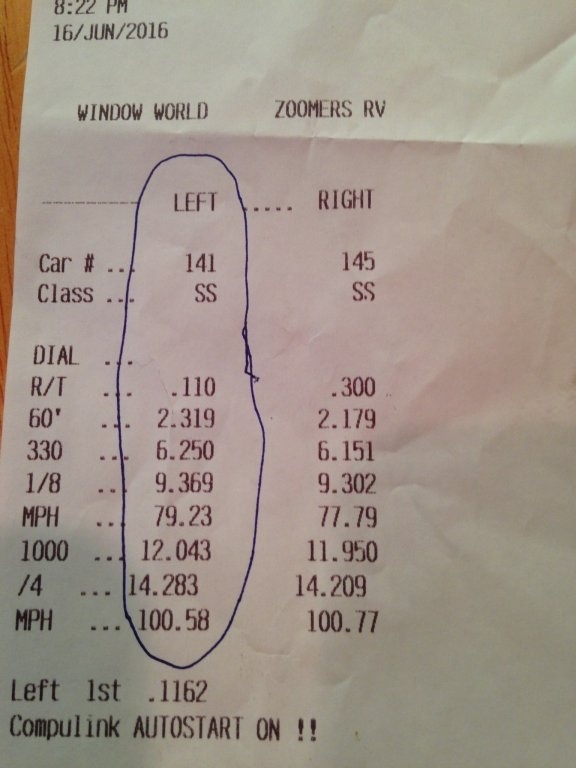

At Muncie I ran 14.2 at 100 mph on street tires 275/60/15. Cooper cobra
Traction problems off line. 2.3. 60 ft time
What size slick tire with no mods to car?
