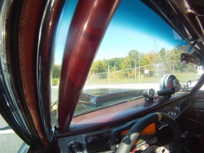

Do you have the mechanical gauge already? if not get an electric fuel pressure gauge and mount it inside on the dash like mine.
Tape will not hold the gage outside the car. As SuperStockRacer mentioned, if it is an electric/non-mechanical gage, then mounting inside is a great idea. By NHRA rules (and for safety) mechanical gages MUST be mounted outside of the passenger compartment.
