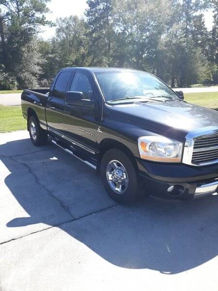

With today's car washes, I don't think the original antennas can survive this. The first time I ran my 2006 Dodge truck through a car wash the antenna came out bent. It is a one piece solid antenna if you are not familiar with them. I replaced the antenna and now keep it finger tight just for that reason. I remove it before a car wash. 68-70 antennas can be done the same way, but you are out of luck on a 66-67 antenna.

With today's car washes, I don't think the original antennas can survive this. The first time I ran my 2006 Dodge truck through a car wash the antenna came out bent. It is a one piece solid antenna if you are not familiar with them. I replaced the antenna and now keep it finger tight just for that reason. I remove it before a car wash. 68-70 antennas can be done the same way, but you are out of luck on a 66-67 antenna. View attachment 1004605
Today's washes are actually easier than the 70's washes. But yes, my '03 Ram had antenna bent and bent the fender where it mounts. I now do the same, leave it finger tight.
