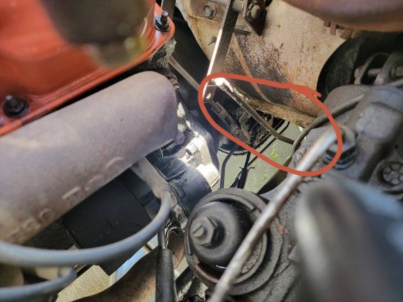

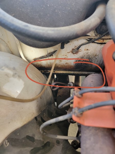

Hi guys i got a 64 chrysler newport and i just noticed a leak under the hood right in front of the passanger side and driver side can anyone give me any advise on what it could be or help me in the direction.
Thanks ahead of time
PS driver side seems to leak alot more

You are marking the firewall. I would guess the heater core if it's back there.
Yes to toolmanmike. I saw the coolant on the floor on drivers side but nothing on the passenger side.
Heres a small clip from the top. I comes from the top it looks like but i see no connections back there besides some small metal lines that run somewhere back there. These pictures are from the botton by that firewall.

So frin further inspection it is leaking from the bottom of the cover down to the firewall... not from hoses...
What type of seal is used to remount cover after removing cover?
