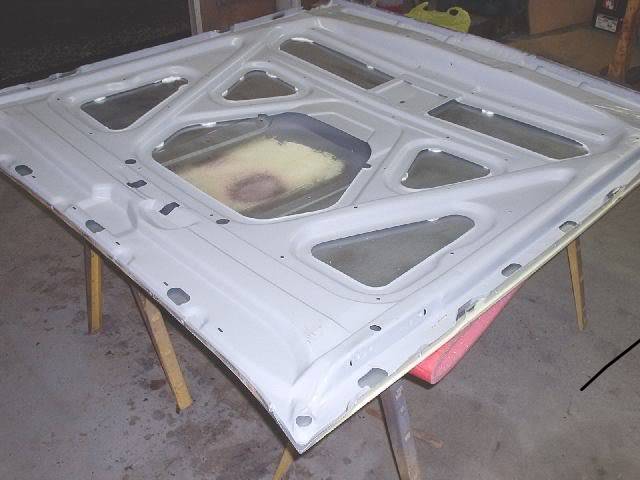

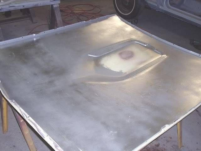

here's a 68 R/T hood I did, but like I said, the 90 degree bend makes it easy..... i welded it back together on the car with fenders mounted and aligned
I've done a hood. All I can say is before the two pieces can be welded back together it has to be on the car and test fit. If it has the smallest twist in it when welded you'll pay hell trying to get it to fit. Try to test fit a piece that has large clamps on it lol, won't fit. I made a jig that fit the hood tight then when I assembled the two halves again the underside sat nice on the jig and it welded up nice and square. Just something to think about.
