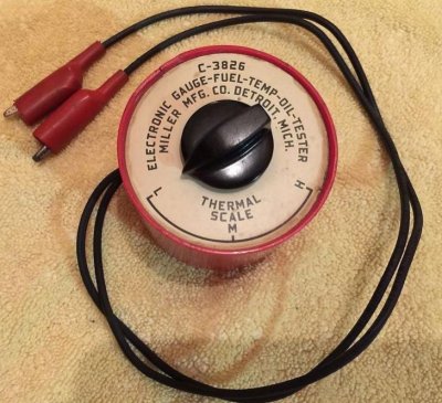

Some time ago I built a functional "clone" of the Miller C-3826 gauge / sender test tool, here
http://www.forabodiesonly.com/mopar/showthread.php?t=179517
Now that Radio$h*t is down for the count for most of us, I was thinking of buying a bunch of appropriate resistances and offering them for sale "for a little bit" so guys can check out gauges and senders,
OR
building and selling a functional substitute for the Miler test tool
Now I'd have to research prices on small project boxes and switches, resistors are minimal and clip leads are easily obtained. So the price would be ?? but I'm looking for opinions on "interest."

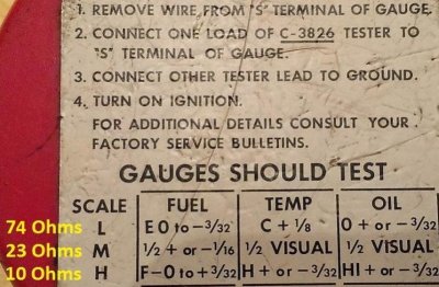

Someone graciously posted a photos of the test tool recently
Well, I have interest since I started this whole thing, I like to build stuff as well, and was gonna look at my local electronics shop for parts, but let me know what you find. 72roadrunnergtx posted the original test unit pics, and mopars & missiles posted some great measurement information as well. All that is over in the thread in the electrical section. http://www.forbbodiesonly.com/moparforum/showthread.php?99876-Troubleshooting-the-temp-gauge-circuit-see-lots-of-suggestions-but-no-real-answers&
