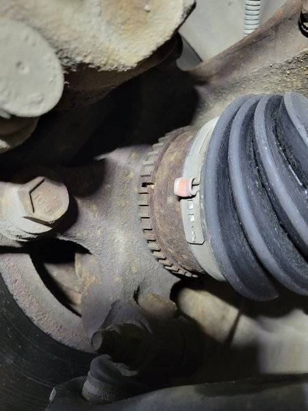

Are they running toothed sensor rings? You have to look close , the rust can literally break them. I actually did one a couple weeks ago , it was on an 08 tribute of all things .
I was at a place that brought in Ontario cars for quite a while and have seen most of the Easter bunny issues.
I was at a place that brought in Ontario cars for quite a while and have seen most of the Easter bunny issues.View attachment 1583493

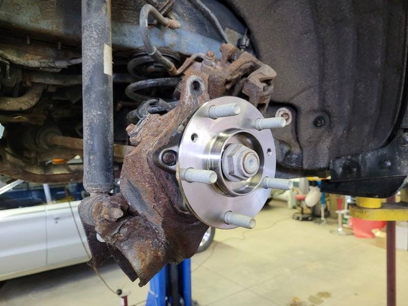

Ya, rears are on the axle like that. Front's appear to use the same bolt on sensor and the sensor ring I can't see with the steering knuckle in the way. Considering just ordering a pair of hubs for the front as they're probably due anyhow seeing the rears were toast. Fortunate I got the pair for the back when I did, today they show Zero stock at Mazda.
You're looking into the Right rear area.. which is what I saw as well just googling around..
Dumb question but assume you tightened the axle nut?
YA.. 220 foot pounds. Picture was pre tightening...

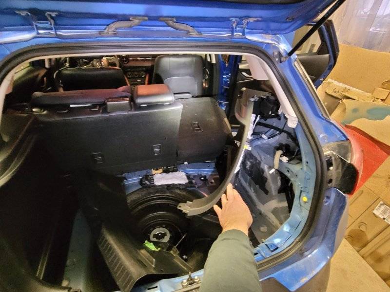

Knowing that she had mice that made a nest in her spare tire a couple years ago I thought I'd check if they chewed wires.. what a cluster f to put the sensor connection in there. I think the rear seat needs to come out to actually get in far enough to change a sensor and harness.
The rear seats usually come out fairly easy like the old cars

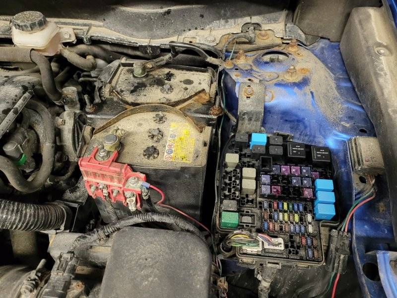

As far as I know a BCM cannot effect transmission operation, but a PCM can. Guess I should dig that battery back out and the battery box as it's under there of all places!

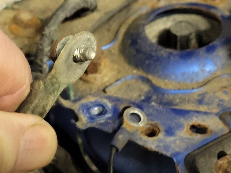

Wayne check ALL grounds as there could LITERALLY be nothing wrong other than a ground. If you find it. Clean it and put Dielectric grease on it and should last awhile.. DAMHIK
