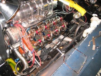

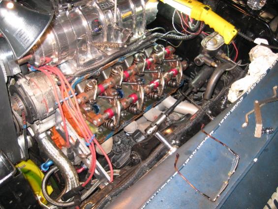

great timing..I just burnt my factory couple today and it broke..So this coupler from flaming river is an easy install? looks like I need one.
Sawzall,done in the car.Dressed the end of the shaft so it would slide on.After it was back together I drilled the hole in the shaft using the holes in the adapter as the guide and pressed in the roll pin:angel10:
