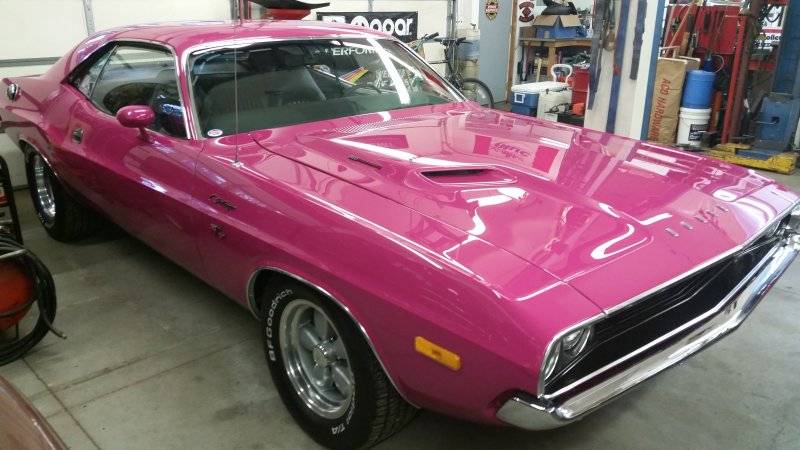

I did my own aluminum trim repair and polish. If there are any pits they will appear as white dots and look bad. Even if they are very small. The alternative is to not anodize. Our Challenger has pieces done with and without anodizing. It was restored in 2004. The non anodized pieces look just as good. All trim is restored factory parts.

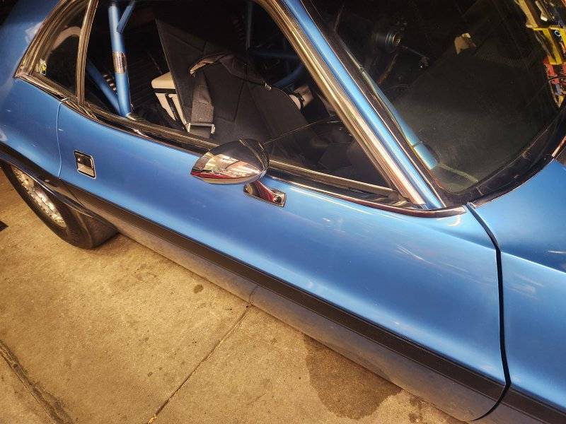

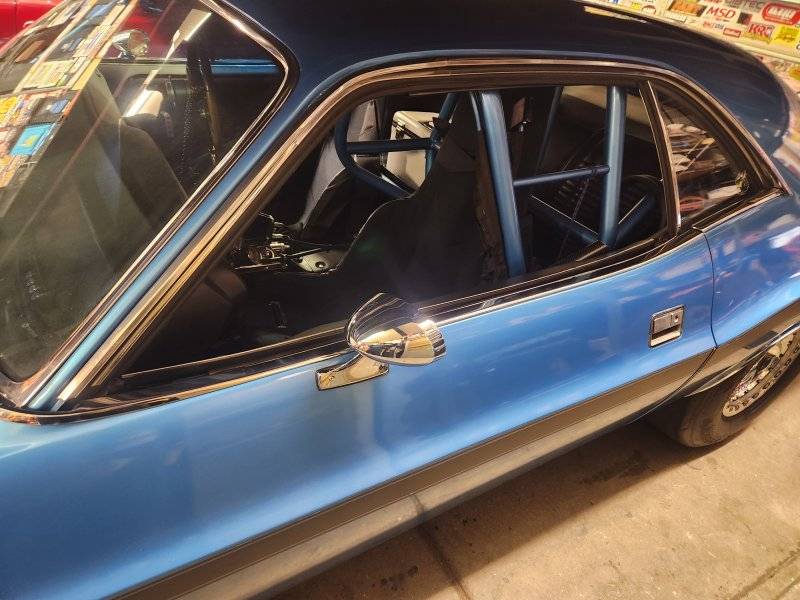

Nice, I didn't know that you had a Challenger also. I just polished and added the S.E. A63 package trim to my 70.
