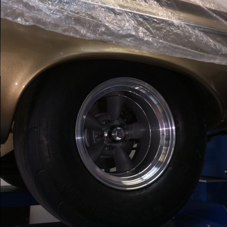

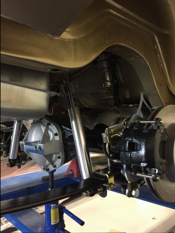

It sure looks like the kit from Right Stuff. If it is I have one on my 64 with the park brake. It went on real nice. The only problem that I experienced is that when the calipers are mounted on the diff, the bleeders are not at the highest point so getting the air out took extra work. You have to unbolt the caliper and get the bleeder at the top and remove the air, then reassemble. Good to go after that. Bolted up real nice actually.

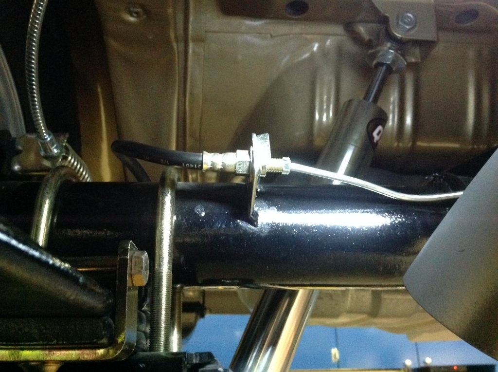

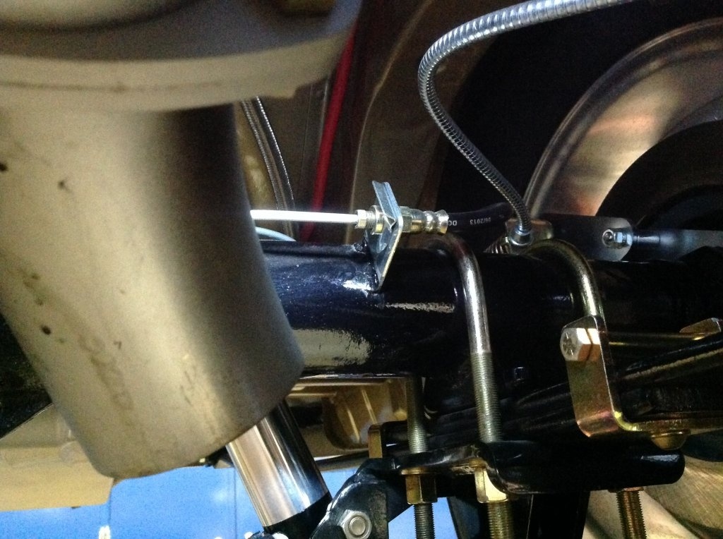

You need green bearings for this kit. The only mod you need to do is weld the 2 tabs on for your brake lines where it changes up from steel to your caliper line. Then you're good to go.
Please you show where you welded the tabs to with orientation.
Weld the tabs where it best suits your caliper hose. This is where it worked best for me.
Right Side (Passenger's Side)
Left Side (Driver's Side)
