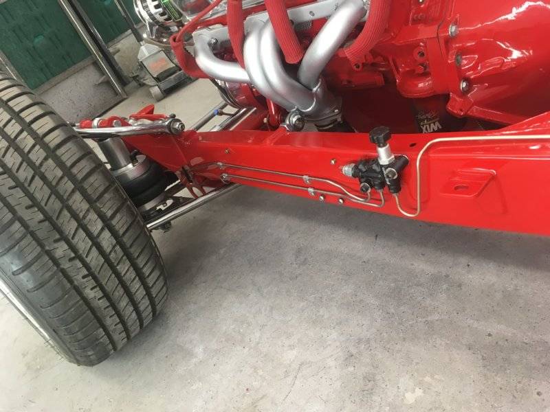

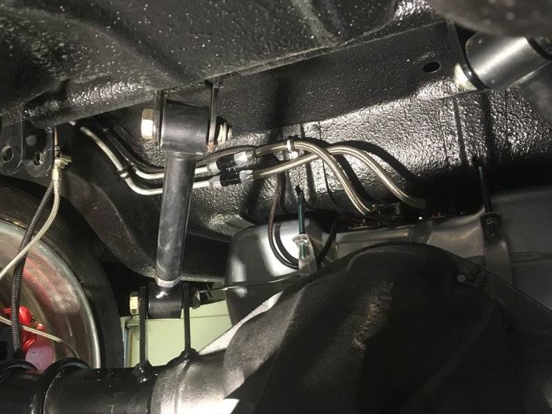

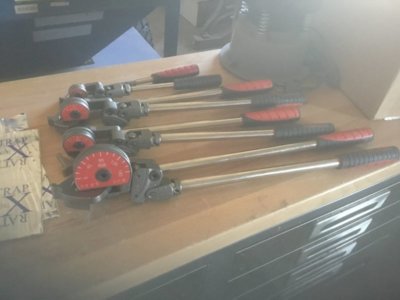

Ive used Nicopp line along with ss and regular steel and copper and aluminum. The Nicopp is the softest, so soft it is hard to keep it straight on long runs, (like down a frame rail.) If you want pro looking lines you need pro level tools. The best bang for the buck is the ridgid 600 line of tube benders. Go with swagelok if price is no object. I wouldn’t put sand in the tube, too risky if it doesn’t all come out. If you cant afford a good tools, try a little vaseline on the outside to help the tool slide around the radius easier. Also you can lube the inside with a small amount of motor oil and put wire ( 8ga for 3/8) through the tube to prevent it from crushing. Remember, only make one bend with the wire inside the tubing, then pull it back to where the next bend is as so on. If you do more than one bend with the wire inside it can get trapped inside. With good benders you shouldn’t have any problems and make bends like in the pictures.

I really appreciate the response and your lines look awesome.
i have no problem at all buying tools, it is one of my weaknesses and I love good tools. I have a number of benders, I cannot say they are high quality but they are not super cheap either. I have never tried the Rigid 600 but I will give it a try, I am going to need a 3/8 and 1/2.

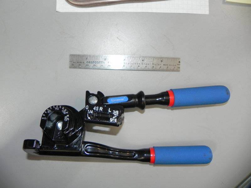

I just finished replacing the fuel line on my 69 Coronet with 3/8" Copper Nickel tubing from Inline Tube (Inline Tube part number CN6) and it worked well for me. It has a wall thickness of 0.028". I didn't have any problems with the tube collapsing when I bent it. I have attached a picture of a test piece that I bent and the bender that I used. The bender is an Imperial 470FH.
Inline Tube doesn't list what the composition of their tubing is, so we can't compare it with the NiCopp that you are using. At one point I looked at using some Swagelok fittings with this tubing, but they only mentioned 0.035" wall in the fitting specs, so there is heavier wall tubing than I used available. I expect that heavier wall tubing would be harder to bend and require a larger bend radius.
I did use a bit of lithium grease on the sliding portion of the tubing bender, which made the bending somewhat easier.
Hope this is some help to you. Cheers!
